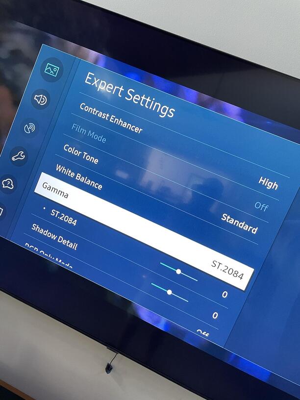

I launched the Plex TV Samsung App and played the same movie, thought INFO shows something different:
But when i go into the picture settings i saw that it changed to st.2084 which i believe is dolby vision?
If that is the case then I believe the Samsung Plex App is indeed playing HDR content properly

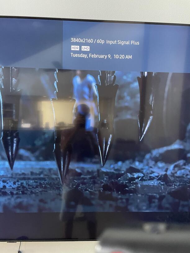

this is what the apple tv 4k displays though
Here is the APPLE TV 4k directly plugged into the HDMI 2 of my Samsung, pressing info you can see UHD and HDR

but isnt that setting st 2084 indicating that its HDR? When i use my Appletv through my rx (which does not support HDR) I only get Gamma 2.2 and bt 1886.
When I use the samsung plex app i get gamma st 2084
You would have been getting HDR10 not Dolby Vision because Samsung don’t make any TVs that are Dolby Vision
Gotcha, but it shows that the samsung plex app is infact passing HDR through to the TV as im getting an HDR gamma setting?
You’re correct that ST 2084 is an HDR gamma thing (PQ or Transfer Function or Curve).
ST 2084 is also used by normal HDR10.
Some Dolby Vision Profiles use ST 2084, but others do not.
