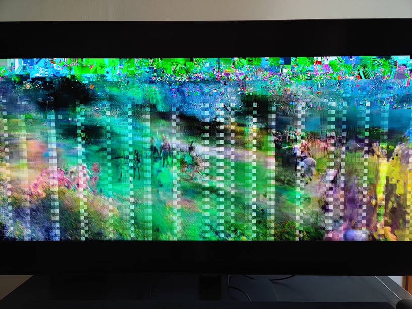

4K HDR movie playback broken on 2020 Samsung TV
Server Version#: 1.19.5.3112
Player Version#: 5.1.2
TV Model: 2020 Q80T
Media information:
<Media id="77960" duration="8476224" bitrate="27752" width="3840" height="1600" aspectRatio="2.35" audioChannels="8" audioCodec="truehd" videoCodec="hevc" videoResolution="4k" container="mkv" videoFrameRate="24p" videoProfile="main 10">
<Stream id="72600" streamType="1" default="1" codec="hevc" index="0" bitrate="22487" language="English" languageCode="eng" bitDepth="10" chromaSubsampling="4:2:0" codedHeight="1600" codedWidth="3840" colorPrimaries="bt2020" colorRange="tv" colorSpace="bt2020nc" colorTrc="smpte2084" frameRate="23.976" height="1600" level="153" profile="main 10" refFrames="1" requiredBandwidths="56784,53217,46020,39722,33676,31864,29220,26896" width="3840" displayTitle="4K (HEVC Main 10 HDR)" extendedDisplayTitle="4K (HEVC Main 10 HDR)"/>
Playback with direct play for all my 4K HDR movies is broken on the new Samsung client. The old one works fine. Audio keeps playing normally, video is a garbled mess. Looks like this:
I’m not sure whether this is an issue with 4K, HDR, HEVC or the combination of these since all my 4K videos are HDR.
Does this happen for all movies? And is it only for HDR movies? If you play a webshow video for instance, does this happen?
All my 4K HDR movies have this issue, normal (SDR) 1080p movies work correctly.
Like I mentioned, all my 4K content is HDR, so I’m not sure if this happens with all 4K content or just HDR. I’ll try to grab a normal 4K HEVC video from somewhere and see whether it plays correctly.
Edit: I downloaded some 4K & HDR test videos from here https://4kmedia.org/ and they seem to play correctly, so seems like the issue is something more specific than just 4K HDR HEVC. I don’t think it’s an issue with the movies, they play correctly on all my other players, including the old samsung app. Not quite sure how to debug this further though.
Edit 2: Well this is getting even stranger, in some of these movies switching the audio track from TRUEHD 7.1 to AC3 5.1 fixes the issue with video corruption, even though audio was playing back just fine on TRUEHD 7.1 as well. In some of them switching audio track does not help.
Edit 3: Did some more digging with playback info enabled, from the looks of it this issue happens when audio needs to be transcoded. Actual direct play where everything can be played directly works correctly, but when audio needs to be transcoded the video gets corrupted.

Rauttis thanks for doing the leg work. I finally got around to testing streaming 4k content on my setup today. After spending a few hours trying to figure out what was wrong, I stumbled upon this. Can confirm, there’s something with the transcoding of audio that’s corrupting the video. In my case, specifically 4k HDR content with true audio where the audio is being transcoded to AAC.
My only 4k content is a HDR test file with true audio
My 1080p files with true audio transcode to AAC just fine

I’m experiencing the same issue on my Q95T. It sometimes happens after 30 minutes, sometimes straight away and only if the audio is transcoded. The video looks like the first post from Rauttis and the audio plays without problems. The solution is to convert the original file to AC3 but the the main reason I’m using plex is to avoid this

Seems like if I switch off truehd or master audio to eac 5.1 or ac3 5.1 it stops being blocky and plays normally…
I have this problem on my Q90T. Seems like it’s connected to 7.1 audio like other posters have said.

This is still an issue with my Q90T on latest firmware. Switching to 5.1 audio fixes my problem, but I have to manually do that for every movie.
It also happens if I use a rip from an original 4K blu-ray (no re-encoding, 50-60gb film. I have to compress it down to 1/3 the size for it to work properly. Tested with ethernet and wireless. Might be a RAM issue.)

I’ve got the same issue with the Plex Player app on a 2020 Samsung QLED TV. Like others, the video playback seems to be sensitive to the audio settings. There are some 4K HDR videos that will play if set to 5.1 audio (from 7.1). However, there are others that simply won’t begin to play (eternal buffering) even if they are set to 5.1 audio. I’d be glad to help with testing if that would be helpful. Thanks!
