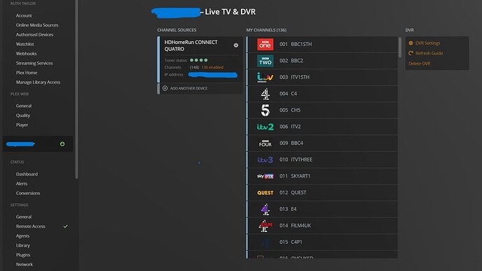

The actual web snippet that loads when you click on DVR config is different to the old one.
It looks like this now:
This is, as far as I can tell the only indication that you’re on “The New Code”
