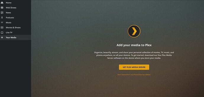

Almost give up... I cannot see my media server once I log in into my NAS Synology 920+
Hi everyone,
I almost give up trying to make PLEX working properly on my NAS Synology 920+. I tried almost everything, but I cannot access my server from my PC, Android, or TV.
In the screenshot, you can see what I see when I log in.
Settings which I already did 10 times: giving permission to plex user, same local IP on the server and on the PC. Port 32400 open.
Any suggestions??

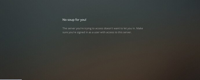

Oh I forgot to reply to what you said before.
The first screenshot is referring to the plex website when I try to log in there.
The second one is when I try to log in with my local IP.

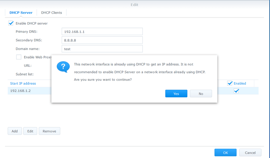

Anyway should I create a DHCP server from the Synology NAS configuration??
What do you suggest to me? Do you have a guide for it?
I really appriciate your help!!!
@ChuckPa
When trying to create DHCP on my NAS I get this message
It looks like you have DHCP running somewhere.
I am going to send a PM so we can look at your other IP addresses privately.
