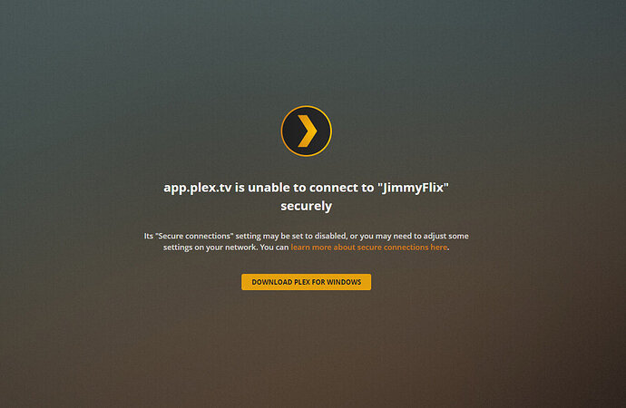

App.plex.tv is unable to securely connect to "JimmyFlix"
Server Version#: Version 1.23.0.4438
Player Version#: Any
Screen_Shot_2021-04-30_at_8.26.36_PM
Plex Media Server Logs_2021-04-27_22-48-41.zip (2.3 MB)
It seems that every so often plex will be unable to connect to app.plex.tv. I’ll restart the service and 15-20 mins later its back to being unable to connect. Now, it usually only happens in the evening and during the day it is fine. When I updated to 1.23 is when I kept running into these issues.

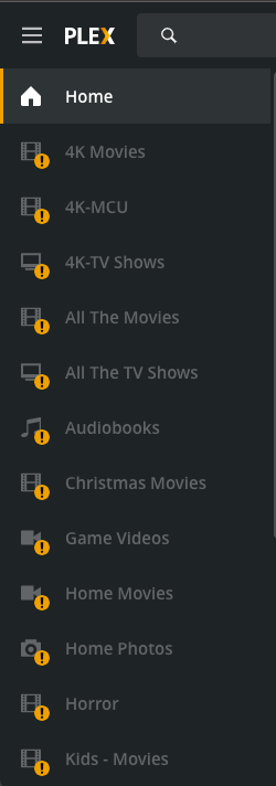

It happened again…This time Tautulli timed out at 2021-05-02 14:12:30
I went to localhost:32400/web and it almost didn’t load. It look alot of time to load the initial page.

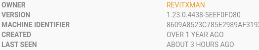

You have to instances of the same server.
what’s going on?
Screenshot from 2021-05-02 15-19-16
Screenshot from 2021-05-02 15-18-45
Which to keep?
I removed Preferences.xml and re-generated it this morning. Then nothing came back. You can remove the newest one as I restored my old Prefernces.xml which starts with 8609a8523c785e2989af3193
confirming –
Remove 8906..... ?
keep the 8609a, remove the 7CE04…
