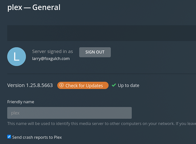

Finally, I see in the server plex General that I am signed in as larry@foxgulch.com?
I hope that is OK.
Apparently I am NOT signed in as larry@foxgulch.com as I added another user to the app as larry@foxgulch.com and attempted to login. Lots of Anthony Bourdain again.

This is the email address which is connected with your Plex account. So that’s correct as well.
