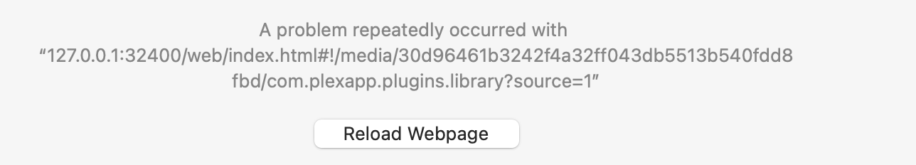

Subject line says it all. Worked great last night, then this morning upon attempt to use it again it neither Plex Server through web or the Mac Plex app can find my media server library. No issues with wifi, running latest version of Mac Monterey 12.1. Didn’t see anything in the forums speaking to problems. Help!!
I should add, I restarted my computer, deleted the Plex apps assuming maybe there was some type of corruption, re-downloaded latest versions of Plex and unfortunately, it didn’t solve the problem.

Updated Plex Media Server 4.69.1
“A problem repeatedly occurred with 127.0.0.1:etc/web/index/html#!/media/long alphanumericfdb/com.plexapp.plugins,kubrart?key=%2Fhubs&pageType=hub”
This isn’t a server version number. they are the desktop and web app version numbers
Would you mind sharing your server logs
