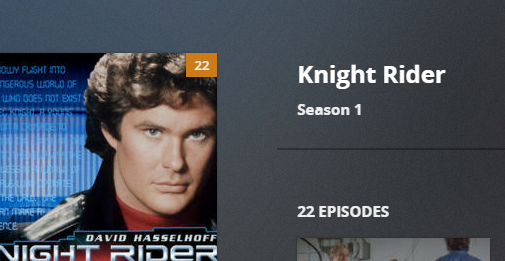

I can’t seem to get this figured out. Normally when I add a show, it is seen on the server as one item until I go into it. I also notice it isn’t able to grab a cover image or thumbnail etc.
I took pics to simplify things:
Can anyone assist me in figuring out what I should try? I am fairly new to this.
As you can see in the first image, it is seeing them as 4 separate things. The last picture shows it isn’t grabbing any data.
It won’t grab any data. It appears to be pulling metadata from the file itself that is causing each season of the show to match to a different show. It is easiest to tell when you go into the season 1 show and see at the top that it is being matched as ‘Knight Rider 1982 Season 1’ instead of ‘Knight Rider’.
This is what mine looks like for reference so you can see the difference in the season page:
The first thing I would do is look at the properties of the files and make sure you don’t have any entries for title as that will get pulled as the show name.
If there is metadata there you would need to clear the metadata, move the show out of the TV Show directory, rescan the library, empty trash, move the show back into the TV Show and rescan the library.
What this does is remove the traces of the erroneous data so that after fixing the metadata it can be added with a clean slate.

I guess since this is an older show without any new episodes you could indeed match them manually to knight rider. The server should combine them automatically after the four separate seasons are matched into the show.
Typically, if this were an ongoing show I wouldn’t recommend that as every new episode would need to be fixed as well, but that fix could definitely work in this situation.

Ok I tested it. First thing I should mention is that if I go to properties on every episode, go to the Details tab, under the description/title it is completely blank. I then did all the steps you mentioned. I removed every episode except the first from the first season and threw it into a separate folder. I renamed it Knight Rider (1982) - S01E01 and left it like that with no episode name. I then added a library named Knight Rider (1982) and directed it to the folder, then to the Season 01 folder. It worked.
The problem I now have is how do I add the other seasons without adding another library? I wanted to add a library that just points to the Knight Rider (1982) folder, and have each season folder within it automatically populate.
