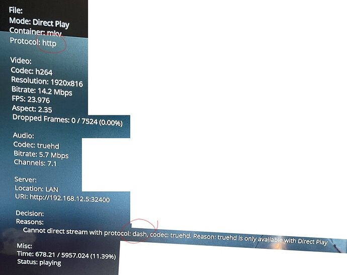

I recently got an Atmos sound system. TV doesn’t support eARC. No problem, I connected the system as follows:
Xbox One X → Sound system → TV.
Dolby Atmos is installed on the Xbox & enabled.
HDMI Audio is set to Bitstream out.
Bitstream format is Dolby Atmos for home theater.
Allow passthrough is checked.
When I launch a video the sound system detects Atmos.
HOWEVER when looking at playback information in a 7.1 TRUEHD movie I get the following warning:
Cannot direct stream with protocol: dash, coded truehd. Reason: truehd is only available with Direct Play.
Notice how it says ‘dash’, because looking at the screenshot, you can clearly see it’s going over ‘http’:
What am I missing?
