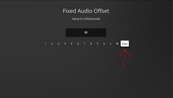

It looks like I have a slight audio sync delay on my setup. I have to set the audio offset to plus 50ms to make voices look and sound correct. The problem is that this settings in the GUI drops out as soon as I stop or exit the Plex HTPC. Is there a way to permanently set the audio offset to 50ms? I have tried to set audio-delay=50 in mpv.conf but it has no effect.

Did you actually use the “Save” button? (sorry, I had to ask)

I use Plex HTPC. I don’t see any “save” option? I use HDMI via Nvidia 4060 and have entered the following in mpv.conf

My above screen shot is also from Plex HTPC. As you can see, there is a Save option.
Yes, I have switched to audio while playing a movie. That setting will not be permanent. Didn’t think it was possible to set the audio delay under the main settings. But don’t think it works, I put e.g. 50ms in the main settings then it says zero in audio delays in the playback settings? I can see lip sync not working.

Then you should set this in the general Settings area of the player, and not in the playback controls of the currently running video.
Now it works! I found that 50ms in the mpv.conf with audio-delay setting has to be set as 0.05 not 50 as I thought it should be specified.
