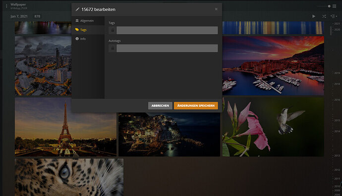

it’s not about the search. The Tags are simply not created. This is from the Paris picture you see in the background.
There is a total of 878 pictures in my whole collection and not a single one gets tages. And yes ALL is enabled based on the guides…
