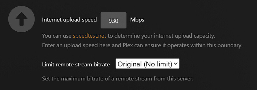

Go to Setting>Remote Access & check that you’re not limiting yourself.
Test your speed a set it accordingly and set your “Limit remote stream bitrate” to Original.
I changed them both to the highest non-original/maximum and then back, neither made a difference in the cap. It is very much behaving as if these connections are through the relay, streams are each limited to 1 mbps (although with the Plex Pass it should be 2 mbps)
What is the client set to? It can limit bandwidth as well.
Clients are also set to maximum/original, you can see them trying to direct play as well.
