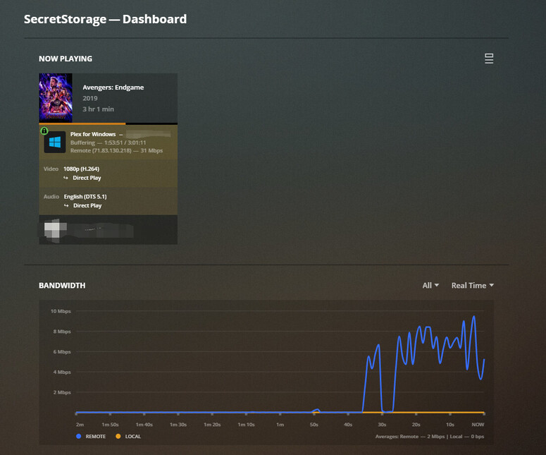

  1. I tried to direct play a movie with about 30 bit-rate, but the bandwidth I see in the dashboard only have around 6M.
  2. I tried to download a movie, and the bandwidth is still around 6M.
    My server can never have more than 10M bandwidth for remote play why? I tried to do local play. I can reach more than 10M easily.
Any helps will be appreciated. thanks.

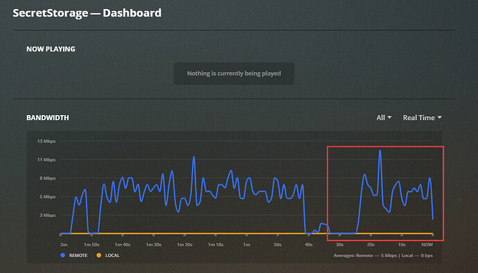

There is no restriction. This is pretty sure. Cause I just found out my system can reach high bandwidth(400M) sometimes, like midnight or afternoon. I am just wonderring is that because residential fiber share line with other families, so upload might be throttle. However, when the bandwidth is slow(50-100M). I did the speedtest on speedtest.net. I can see the speed is still up and down 940. This is so strange.

It looks like you are playing back via plex for windows. Doesn’t that have its own client side connection limits? I think it’s in the same spot as the plex web settings normally are, or above that in the general section or something?
Update: Was able top confirm on my desktop that there is a client-side setting for remote bandwidth under ‘Plex for Windows’ in the settings, and it defaults to 2 Mbps.
Not sure that is your issue though, since it says it isn’t transcoding in the dashboard.
It also doesn’t make sense that the bitrate displayed for the now playing item doesn’t jive with the bandwidth graph though. Is it stuttering or buffering, or playing fine? If it is playing fine and the actual file bitrate (context menu in plex and ‘Get Info’) is 30 then I don’t know how it could be playing smoothly and not have the upload speed exceed the bitrate of the file when direct playing. It should buffer when first playing (so you would see a higher speed than the bitrate if the bandwidth is available) then from there it should go up and down as more data buffers.
Maybe the graph is wrong? Can you view the actual bandwidth from a performance monitor on the server’s OS?
And maybe monitor the download bandwidth in the windows client to see if it jives?
