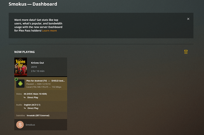

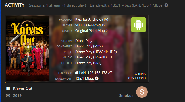

Here are the Logs as promised, and also 2 screenshots. One is form Plex’s Dashbord and the other one from Tautulli’s Dashboard.
