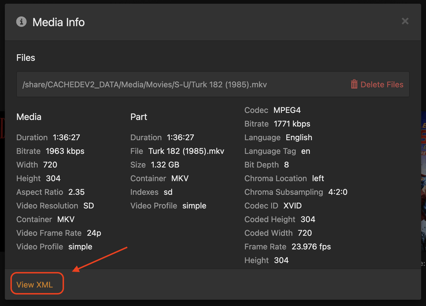

It can also help if you grab the media info from the “view xml” option and post it here (click the 3 dots to get the sub menu and choose “get info”):
