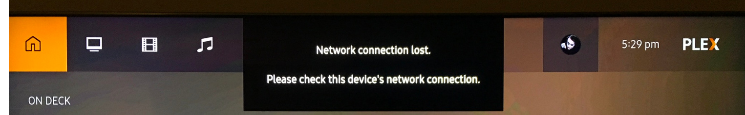

The issue we are experiencing is that when you exit Plex with the “back” button from the main screen and select Exit it is not shutting down the Plex app properly. If you then turn off the TV for a period of time and come back to want to watch something else on plex. When you fire it up, there is a black error box that states “Network connection lost, Please check this Device’s network connection.”.
Our TV is not using Wireless so that isn’t the issue.
Now, if you go up to your account section in Plex and choose to exit this way, the App will close properly and this issue does not occur.
This is repeatable reliably.
This was also present in the previous version of the Plex app but was worse as you had to unplug your TV to get control of Plex and your TV again.
In the newest version of Plex you can at least control the Plex app and exit it from the account menu and remove that black box.
Here’s a picture of the box that I’m talking about.

Unfortunately it still shows that error message occasionally but at least I am able to control the app and do a “exit” from the menu. Not nearly as bad as the previous version where you had to power cycle the TV at the wall.
More daily use and this error box pops up no matter how the plex app is closed down. As mentioned at least now you can move around and close it down a second time to clear it.

Same here on Samsung 2018 Q7FN with latest firmware and Plex app. No matter the exit method, the error appears and requires an exit and reload to get functional app.

I’m only getting this behavior with the latest Plex app. None of my other apps (Amazon video, Amazon music, Netflix, ESPN, etc.) get the “Connection lost” error that is subsequently cleared with hard exit and reload.
@sLumpy I also confirm other apps are not exhibiting this behavior.
