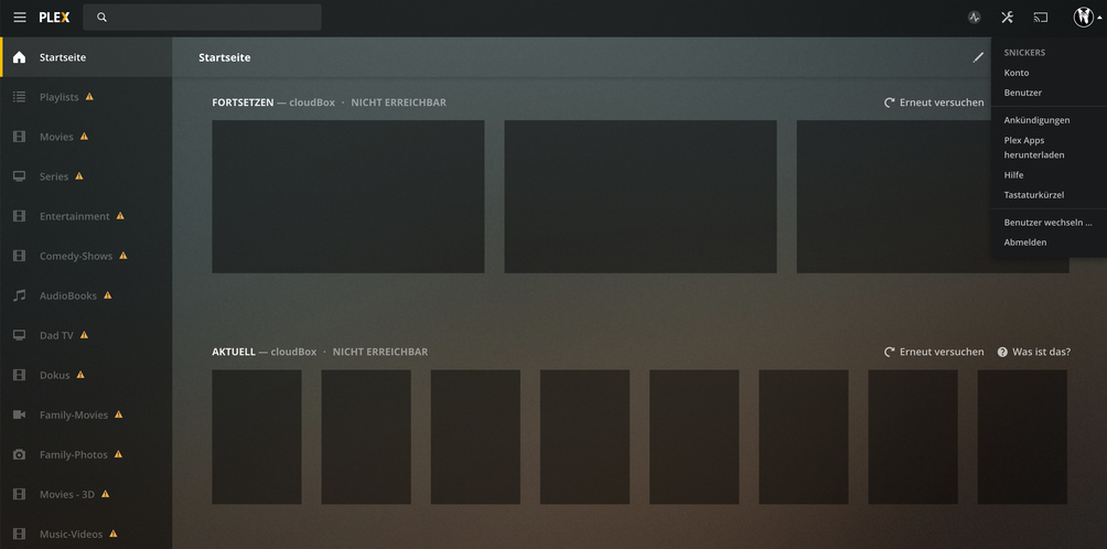

Can not access PMS anymore. Server still running. Edited the Preferences like in the troubleshoot, but does not help. The entries don’t get filled up again. I’m completely on a remote server and i always get redirected to my other servers. Everything else on that server is up and running fine.
Of course i tried the direct IP-Address instead of plex.tv without success neither.

still gets the login … but nothing else? still the same … so i’m in the world between locked out and logged in … ?
never had that many problems with a security “feature” like on Plex … i mean seriously… and not even a single tutorial on how to solve this… how to connect to vpn and so on …
where is the option to disable this ?!
but anyway, this is clearly a bug, since the server was good until today … so maybe a little bit more interest please?
omg !
on one device, still connected to the server, there is even a playback possible !! going through the menu etc no problem! …
same account, same server, new connection - boom, nothing ! OMG
WHAT IS GOING ON ?!?! THIS IS A CLEAR BUG!
awesome… even this

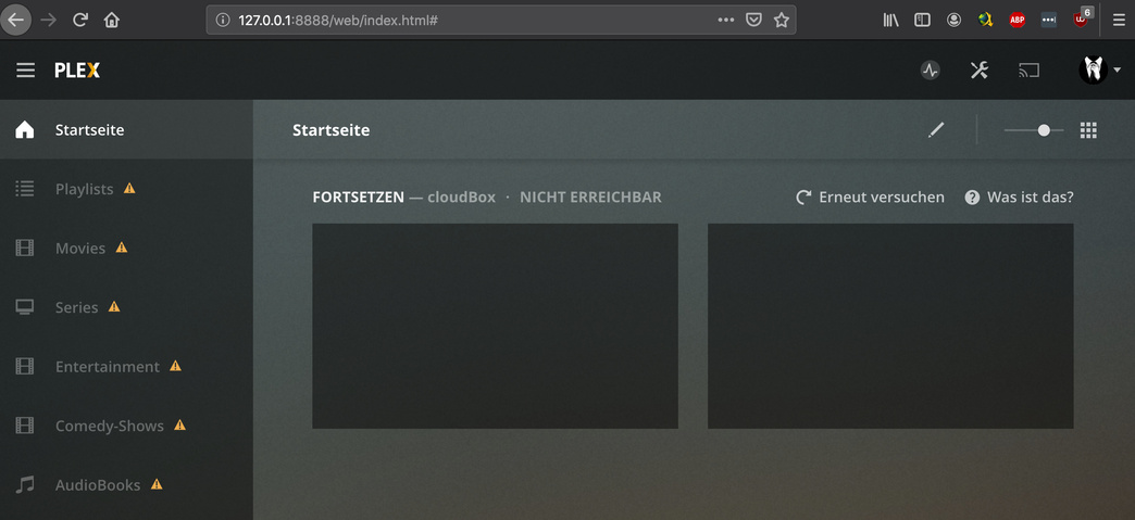

Open a Terminal window or your command prompt
Enter the following command (substituting the IP address of your server as appropriate):
ssh ip.address.of.server -L 8888:localhost:32400
Open a browser window
Type http://localhost:8888/web into the address bar
The browser will connect to the server as if it were local and load Plex Web App
does not work … directs me directly to plex.tv
So here i have a running PMS not accessible in any way … how to solve this ?
May I augment that SSH tunnel sequence?
  1. ssh -L 8888:127.0.0.1:32400 ip.addr.of.host
  2. Sign in and let it sit
  3. Sign out the local Plex/web (upper right)
  4. Open incognito window
  5. In it, open http://127.0.0.1:8888/web
  6. If not presented properly to that server and accessible: then
    a. sudo tar cfz /tmp/plexlogs.tar.gz "/var/lib/plexmediaserver/Library/Application Support/Plex Media Server/Logs"
    b. download and attach that tar.gz here.

incognito tab .. obviously, it gets all the Library’s … but nothing more..
does not show up in settings aswell
still nothing …
must be a bug … not security related , i guess
