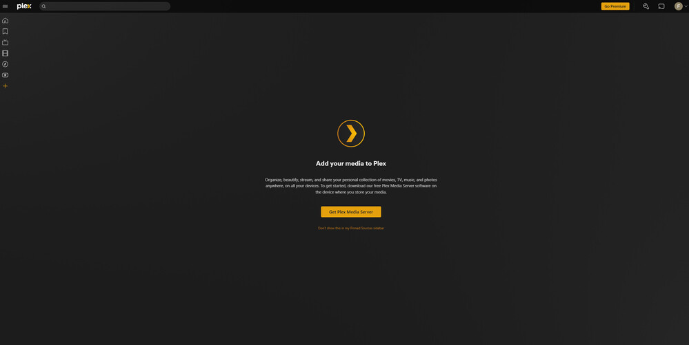

Hello,
I no longer have access to my plex media server for 24 hours, I can’t access the settings while I have an account with the lifetime pass since 2020. The server is no longer accessible, regardless of the platform… an SSL bug?
Thank you

There must be a bug because i either can’t access Plex locally only through Plex.tv.
I am well connected, I have not touched anything, I no longer have access to the server parameter and I no longer see my biotheques…
Anyone else with this problem? I tried to put another version but I have the same… I don’t have access to the log since I haven’t seen on my server’s parameters… thank you.
