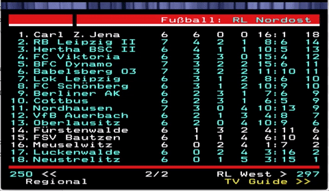

Bug text tv during recording
When record any channel there is a overlay of texttvl

All my recordings save teletext as subtitles and I have subtitles on by default, so I had a similar experience. Try to check if thats the case for you as well.

At least in my case (recording YLE channels in Finland) teletext is apparently assumed to contain subtitles so it gets recorded as a subtitle track. Just selecting subtitles: none made a recording watchable. Of course the real issue then is having control over whether teletext is being used as a subtitle source or not, since it varies by channel if it’s used exclusively for that or like in our case, contains something completely different.
Same here, that’s how it looks like with subtitles1 enabled (a second subtitle option works as intended):

It works when subtitles is set to manual.
It seems like it is fixed for recording tv. Now I have the same issue when watching live tv :-1:
