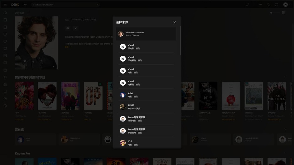

In my situation, some actors’ Credits pages display my server, while others do not. Sometimes, even for the same actor, their Credits page may intermittently show or not show my server. However, even if the Credits page does not display my server, I can still search for content on my server using the search bar. So, this issue does not affect my ability to search for movies on my server, only the Credits page. Although there have been instances where the search page displays incomplete results, I haven’t compared them one by one. In any case, I can still search for content on my server, so the issue isn’t particularly serious for me.

I’m able to reproduce the Credits page issue where the server availability is not listed initially but does show once stepping forward then back. The fix for the Credits page issue is being actively looked into. There is a more efficient endpoint that can be used here. However, as I mentioned above, there was another issue that was raised when we were initially looking at using this endpoint. This wouldn’t impact Search at all.
