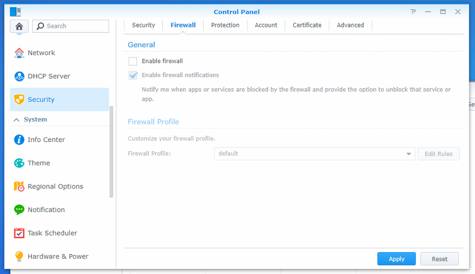

Firewall on Synology is disabled:
Is there anyway I can do a completely clean install of Plex? As when I uninstalled and reinstalled it saved all previous settings. Would this help?

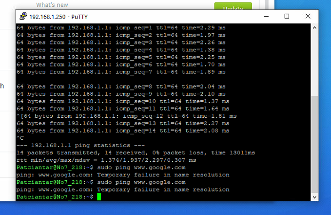

So i’ve just noticed that I am not able to ping outside of my modem.
I managed to ping the modem itself on 192.168.1.1 but I have not been able to ping www.google.com. What is weird is that I managed to update a package whilst the ping was failing… so unless the packages are automatically downloaded, stored locally but not updated I am guessing it means I have some form of internet connected?

I changed the DNS and alternative DNS settings on Network / General / Manually configure DNS server to 8.8.8.8 and 8.8.4.4 respectively and Plex claimed the server immediately. So it does seem to be a DNS issue.
Now my question is this, why can’t I set the DNS server as my modem on 192.168.1.1 which has an automatically configured DNS? I also tried manually overriding the DNS on my modem to 8.8.8.8 and that also failed.
Is it wrong to manually override the DNS settings from the NAS and have them direct straight to google DNS instead of my modem? One of the things people kept repeating on other posts was to ensure that the default gateway and DNS server settings on the Synology are the same IP address…
