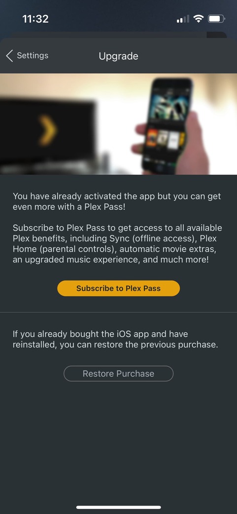

The button is grayed out. Screenshot attached. It does allow me to press the button, and Something happens for about 2 seconds and both buttons sort of lock up, and then go back to normal and nothing else happens after that.
OK. then will need the iOS logs to figure out why it might not be seeing purchase
Your logs show that the purchase was restored and so does your screenshot.
