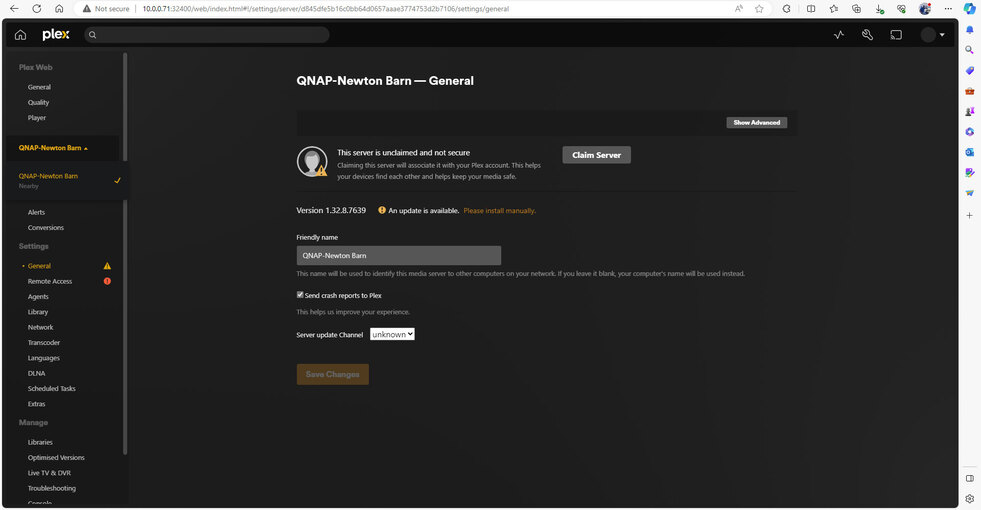

i just updated my network (from BT to Orbi), and pretty much everything is working great - apart from plex.
i cant see my server.
plex server is installed on QNAP NAS, latest version,
in frustration, i deleted earlier installation, which worked fine before network update.
now i am unable to claim plex server- i click the button and nothing happens.

Thanks for the reply, I didn’t mention in my post that I had already removed the server instance from my devices.
i click on ‘claim server’ and nothing happens
