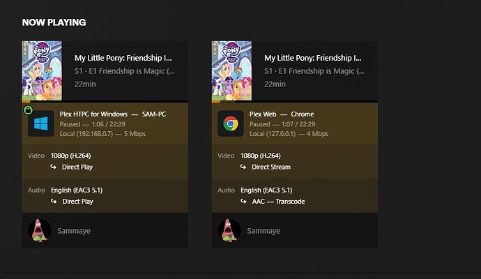

It works fine in the web browser at times, it seems to sometimes detect a transcode:

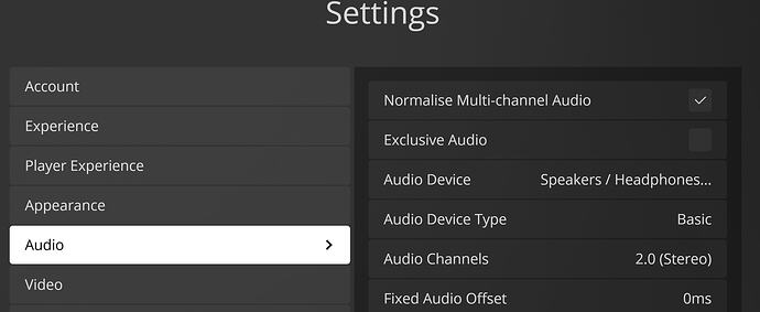

but it is always broke in the plex HTPC. This does happen on other devices but normally selecting the audio device and configuring it manually works, but this time it isn’t.
I also know it isn’t hardware since I have a HDMI monitor with built in sound and it doesn’t work there either.
All devices seem to use direct play as well.

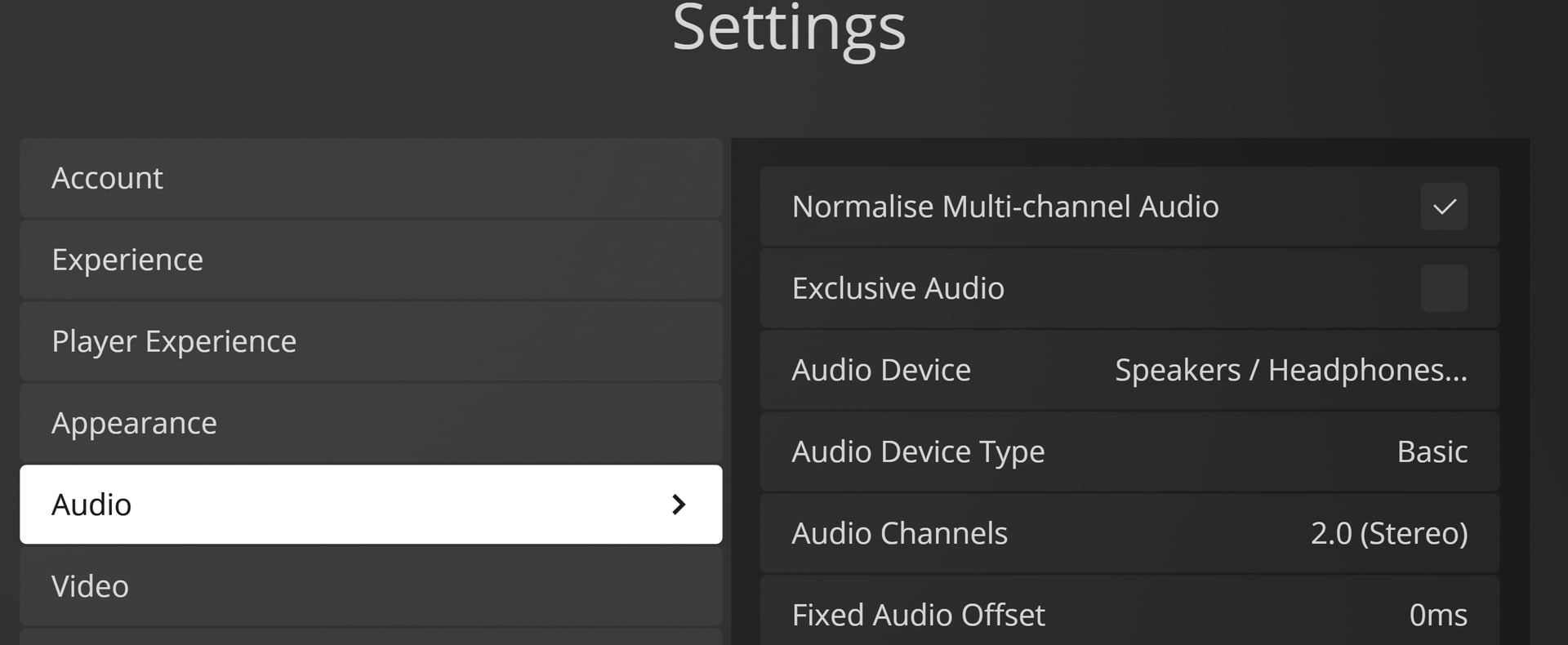

In your screenshot, “Audio Channels” is set to stereo.
Yes, sorry, my speakers are stereo only
Then how are you expecting to get surround sound?
Via transcode down to 2.0

On web browser I do since as shown in my update it transcodes to 2.0.
