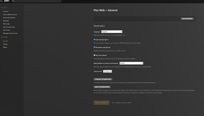

After resetting my password and logging out of devices I could reset passwords in the app on my phone and Android TV, however today my Netgear ReadyNAS needed a reboot and now my plex server is no longer visible. If I open the web portal locally on the NAS there is no SERVER option under SETTINGS. Please help, I have lost not only access to my files but I also subscribe to LIVE TV and now I cannot record programmes

So, I just reclaimed my server. I had to go to the Plex Media Server on my NAS via the local LAN IP, and was then able to reclaim it and login.
