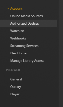

The “Media Server → General” section is not appearing for me. I assume this is due to certificate and plex.tv availability issues.
Looks like you are not connected to your server. Did you use the http adddress (not https) of your server?

I am having the same issue. I reset my password after the email that went out this morning and did a “sign out of all devicea” and immediately lost access to my Plex Server. I tried removing the server from the list so I could re-add it but I don’t have the Media Server > General option available either. Really hope this is a temporary site issue…any help/info would be appreciated.

From what I can see on my authorised devices there is one from 3 hours ago and one from 16 hours ago.
The newest one is the one I don’t need.
My original server was created several months ago though.
