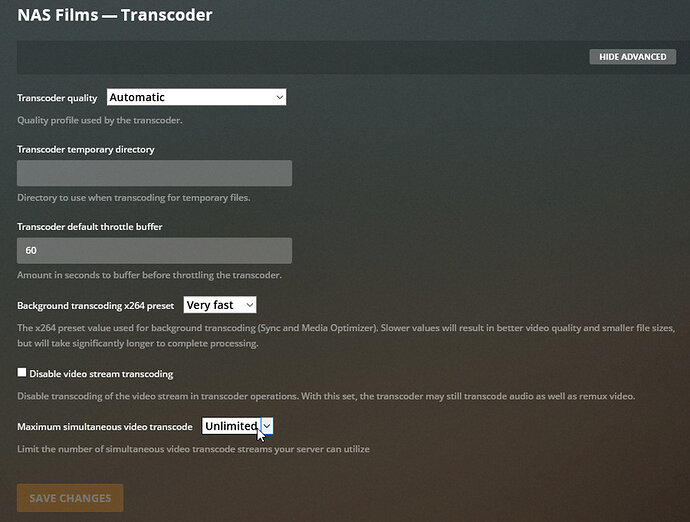

Have you maybe disabled the server from transcoding (Settings > [Server Name] > Transcoder > Disable video stream transcoding)? This could cause the video not to be played if it cannot be played as-is (e.g. if you configured your Android Plex app to play videos at a lower bitrate/quality when connected remotely or if this is a format the Android player cannot deal with).

Did Disable video stream transcoding
In that case it could be as simple as your server not being powerful enough to transcode your videos (at least for that particular video).
