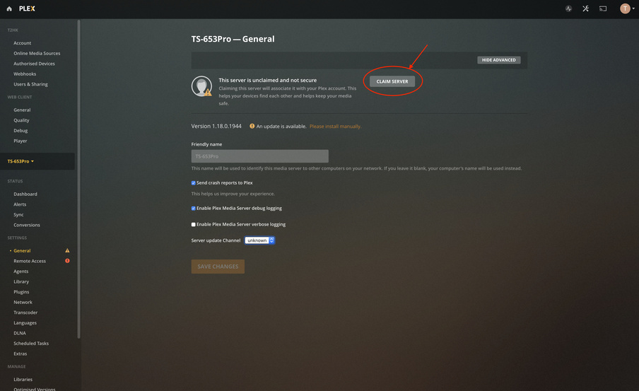

This is the screenshot I get:
Please note that I have installed the latest Plex version on the QNAP server. Yet I keep on getting this notification about performing a manual installation.
Also, I couldn’t exploit the link in your above reply as is is reliant on retrieving my X-PLEX-TOKEN. However, I have no Library item to browse to, and hence can’t retrieve the said token.
Have you tried to claim the server?
