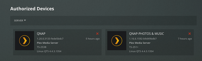

Go to Settings - Authorized Devices - Servers (dropdown) (this is in the upper left corner) of Plex/Web.
Look for the server name and see if there is a duplication.
If there is, delete the oldest one(s) and then try again

I didnt see duplicate there. But I stopped server and restarted it and got same error.
