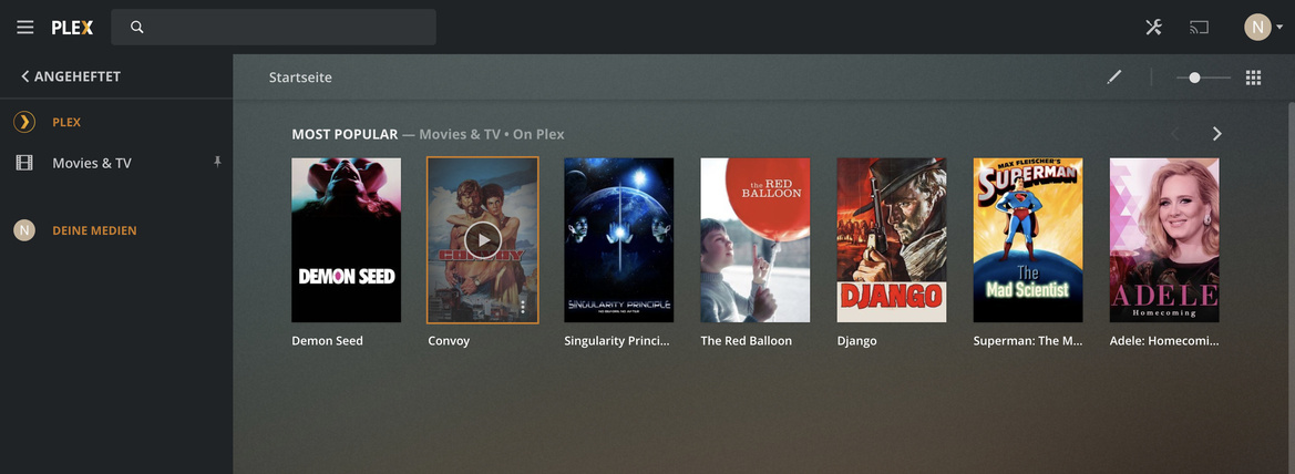

I have installed the Plex on my Synology DS1019+.
Plex Server Version: 1.18.6.2368.
Now i want to add my Shared folder from my NAS.
But i can’t see any Server settings to add my NAS as server.
i’m in the local network and i have some access to the NAS.
What am I doing wrong :pleading_face:

Unfortunately I still don’t see the option.
It may have something to do with the PLEX version you have, Plus, I can only read English, Sorry.
If the images shown are the NAS version of the PLEX app, I have to point out, mine was a lot different to what I see with yours, mine instantly showed me options to add my media.

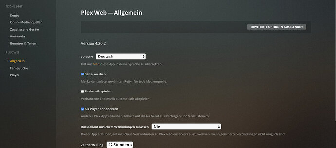

The problem is that I have no icon at this point to add libraries and it cannot find my server even though I have installed it on the NAS.
I reinstalled Plex, but I still can’t see my server.

My NAS are in my DMZ with the IP range 192.168.16.0/24, the laptop and other computers in the 10.100.15.0/24 network.
In the browser I call up the IP of the NAS (192.168.16.200) and see no server there although the Plax server is running on this IP.
Does the Plex server and the clients have to be in the same network for this to work?
Both are signed in to my plex account
Given they are on two different IP subnets, you must use SSH-tunnel.
