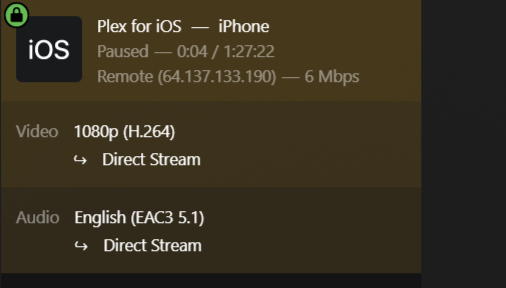

omg ii think it worked, you guys are awesome, it was ESET, im still testing but i made the eset rule and to allow the port and now the same person is REMOTE is that what i want???
Appears to be working. Technically you’d want a direct play but I’ll take a direct stream over an indirect play any day
A Direct stream indicates that the iPhone doesn’t like something about the format but it’s an easy convert on the fly with minimal resources
Unless I’m missing something obvious I think you’re in good shape
thanks man what a nightmare so someone else that was getting 320 now has
