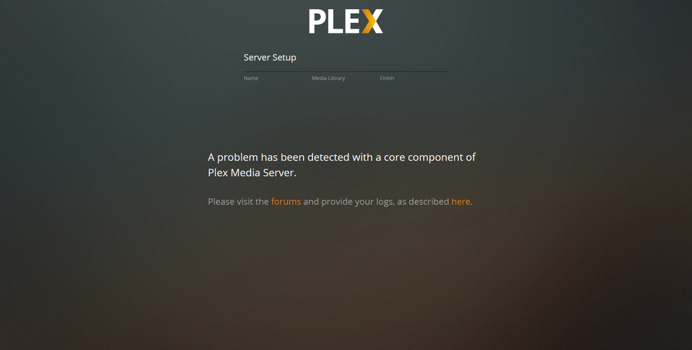

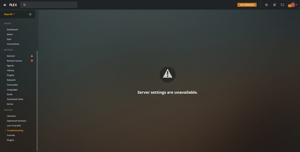

Can't start a fresh new server after uninstalling Plex Server
Server Version#: 1.20.1.3252
i’ve uninstalled my current Plex Server installation a dozen times already now. Also cleared out its Registry Key and the %localappdata% folder. But everytime i launch the newly installed Plex Server instance, all i get are a bunch of errors. Are there anything else i have to do aside from removing the Registry Key and the %LocalAppData% folder for Plex Server? see below screenshots, i’ve tried extracting a Log from the Web App but it didn’t work either:

Something on your network or Windows is blocking Plex Media Server from communicating properly back to itself using 127.0.0.1:32400. I can’t tell what it is, but there is something wrong.
