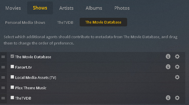

Here are the settings for each as requested with images.

If you use TheTVDB agent, the embedded metadata (which are probably wrong) from your files will interfere. Due to the ‘Local Media Assets’ (LMA) being enabled and sitting at the top of the list.
On the other hand, you have LMA completely disabled in the TMDB agent.
This is the reason why you are seeing so totally different results, depending on which agent you define as the default for your library.

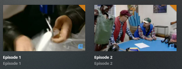

Ok, I did everything you mentioned including doing both the Plex Dance and Fix Match options. I did remove the episodes out of sight of Plex, did the scans, etc. When I moved them back in and let Plex detect them, the overall show and individual season artwork did appear to match to TVDB and pull through correctly, but now each episode simply is titled “Episode 1”, “Episode 2”, etc. I attached an example below.
I even tried creating a new TV library altogether and move just that show into it and its the same result as the picture below. I also tried “Refresh All Metadata”, and unchecking “Local Media Assets” on all agents just to be sure nothing else could be polluting the library.
Once again I feel it is coming back to my Plex server / database remembers the media was matched before and is battling me to rematch it regardless of what I do. There are new episodes I am recording from the Live TV & DVR and they are getting added to the show’s library and matching with metadata and descriptions pulling through with no issues so I’m really at a loss. Is there an option to force Plex to forget all previous matching it did for a specific library without have to delete and reinstall Plex altogether?

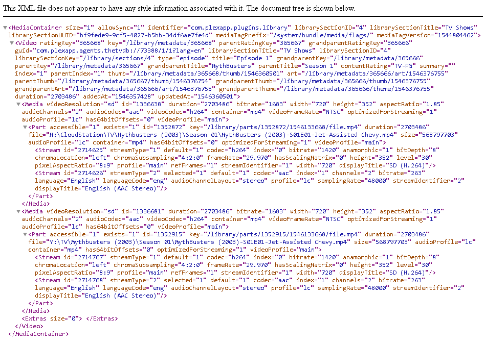

Please post the Plex XML info of one episode of this particular show.
There are no episode data on TheTVDB for S01E01.
Because the season numbers of this show were changed to 4 digit ‘year’ numbers.
https://www.thetvdb.com/series/mythbusters
You’ll have to rename the files and folders of this show.
Filebot can do this very quickly.
