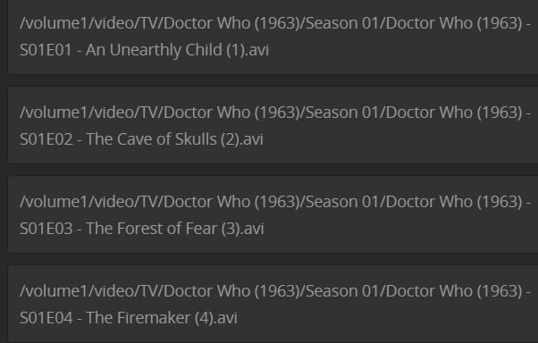

Hi I read all the other posts of people having problems and tried moving out my files, renaming my files to this:
Then I did the plex dance without missing any steps and re-added the files.
Now its still missing the metadata. Not sure what to try next?
