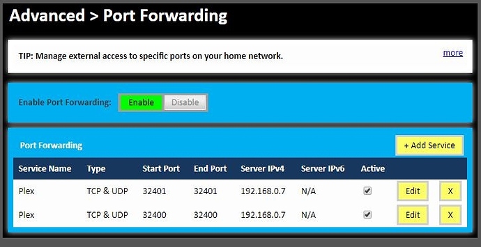

Hi, did you get this resolved? My ISP just switched me from an Arris which I had configured to a Technicolor TC8717T and I’m having similar issues with remote connectivity. I’ve followed this thread and checked all of the preliminaries to no avail. What’s throwing me is the port forwarding nomenclature is different than I’ve seen.
Delete the 32401 port forward rule
Make sure on the server setting you have manually specify port selected and 32400 entered in the box
Make sure the IP address 192.168.0.7 is fixed - e.g. A dhcp reservation
Suggest adding port rule in the firewall on the server computer

Thank you! I walked through it step by step and did these one by one. All done and checked out, but on the last step, the public ip I saw on canyouseeme.org was correct, but when I clicked on check port it said it could not see my service on port 80 which it defaulted to. I changed it to 32400 and it erred that the connection was refused. Not that it isn’t clear, but I don’t understand exactly what I’m doing. :wink:

I can see that your server reported to plex.tv it was on 192.168.0.4
So it your server is on 192.168.0.4 then your port forward in the router is going elsewhere - to whatever has ip 192.168.0.7
Decide which IP you are going to stick with and fix it - and do not switch between wireless and wired. Stick to one or the other - in case that is why it changed
Yes, I understand and am sorry for not explaining it up front. As best I can tell, here’s what happened. I took the snapshot of the port forwarding rules this morning after which my ISP did a factory reset on the gateway trying to solve another problem. The server then showed up as 192.168.0.4. I then did a dhcp reservation on 192.168.0.4. I should have updated my pic. I am hardwired only.

It is possible that it is just a timing issue on getting the status page updated - I have actually just tried your public ip and port 32400 and I got through to your server and got challenged for a login - which means the port forward is working fine.
