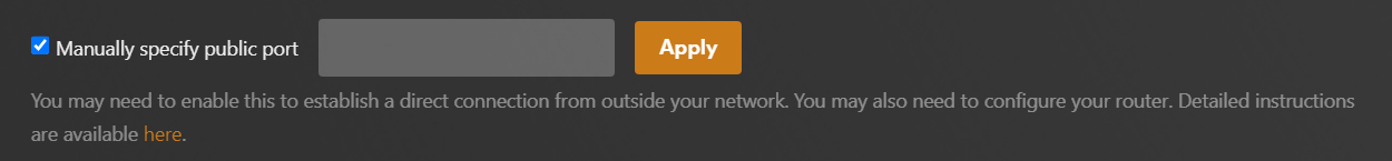

internal port :32400
External port: 35678
Is this the right config ?
Tia.
So you have this set to 35678?
And the IP address shown above matches the IP you set for your server?

My internal and External port in router port forwarding is set to 32400
and same port set in Plex server. IP is static.

@minthos Can you PM me screenshots of that remote access page and your port forwarding rule from your router so I can check they are set properly?
I think I have fixed it. Had to select “both”( TCP, UDP) under Protocol under Unify Dream machine port forward section.
its working as expected now. Will report back if I face issues again.
