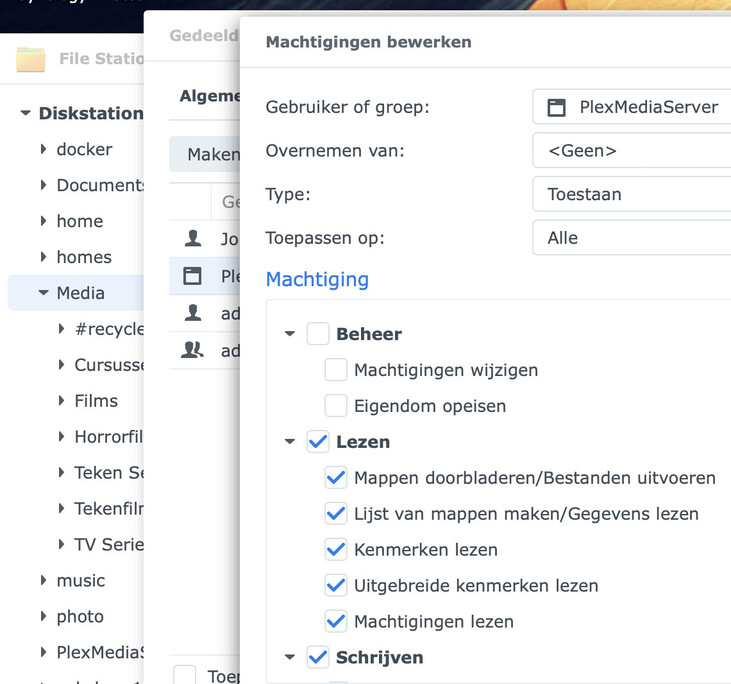

Here you have a screenshot of the permissions. PlexMediaServer had read and write permissions.

Don’t know what that says but im assuming it says something like the following:
Type: Allow
Apply to: All

When setting permisions, make sure to check the box for “Apply to this folder, subfolder, and files.”
You can see the checkbox at the bottom of the middle window. It is partially covered, but starts with Toe…

I applied the checkbox.
