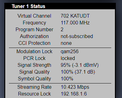

I am not sure why the strength is so low. and the quality0. I started a stream on WMC and attached that screenshot. But the signal and quality are 100%. I also watched plex try on 702 from the hdhomerun diag screen, and saw that it connects, and gets a good signal strength, but the quality never goes above 0, and then plex stops trying, and the hdhomerun diag goes blank because the stream stopped. Hope that makes sense.

Your HDHR (192.168.1.9) refused the connection request made by Plex to stream channel 702:
Mar 26, 2019 11:52:30.549 [0x151c459e9700] ERROR - [Transcoder] http://192.168.1.9:5004/auto/v702: Server returned 5XX Server Error reply
I saw that error, but was not sure why this would be the case when other apps can stream the channel just fine from the same tuner on the hdhr. I’m going to uncheck that channel on the .9 prime, so that only my other one (.8) will be used. just to see.
I have trouble with my lone VHF channel. We just need a better VHF antenna.
well crap. So it loaded up 702 just fine on the .8 tuner. I tried another channel that wasn’t working and it is now working too. the other channel is on the .9 right now. I just re-checked 702 on the .9, and it is working now too. Just before I unchecked the channel, I did try, and it had failed. So I dunno what caused this? but 702 is now playing on the .9 tuner just fine.
So I am noticing a lot of artifacting. And the signal quality is hovering between 60-70% :frowning: I just turned off 702 from the .9 and am looking now at the quality to the .8 hdhr, I also have the same channel streaming on .8 from my htpc running windows media center.
WELL PISSSSS. okay so 702 is working fine on the .8… I just forced WMC to use the .9 only, and it has the same issue of really poor signal. I am going to swap the coax cables going to each, and see if the signal follows, or I guess my HDHR may going out. I guess this may not be a plex issue afterall… Which makes sense since I hadn’t done anything, other than upgrade a few days before leaving, and all was working fine…
