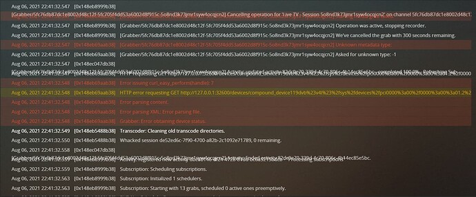

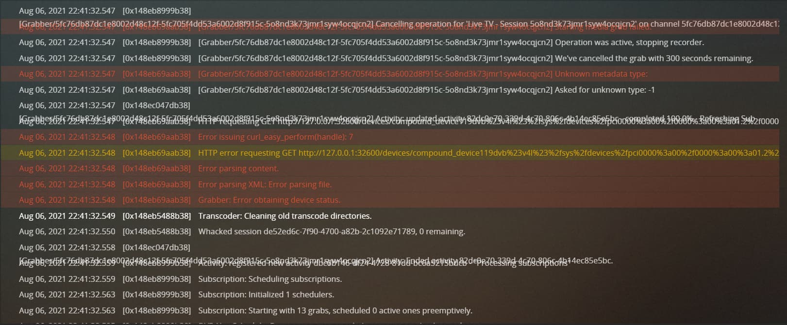

I can see the Plex Tuner Server.exe process crashing with an Access Violation windows error 0xc0000005
Jul 31, 2021 13:50:15.787 [20980] DEBUG - Jobs: 'C:\Program Files (x86)\Plex\Plex Media Server\Plex Tuner Service.exe' exit code for process 11872 is -1073741819 ()

Ok, so I reproduced this morning using server version 1.24.1.4931
I’m using a Hauppauge WinTV-quadHD with driver version 1.59.39012.0
Attached is the log showing tuning failures and repeated crashes of Plex Tuner Service.exe. Additionally, here are three DMP files from the crashes zipped up as well.
Plex Media Server Logs_2021-08-20_08-31-59.zip (1.6 MB)
DMP tuner crashes.zip (70.3 KB)
