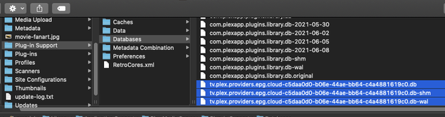

Can you go to the plex data folder and inside that /Plug-in Support/Databases
In the Databases folder there should be three files that start with tv.plex.providers.epg.cloud a .db .db-shm and .db-wal file. Back these files up somewhere just in case like put in a folder on your desktop then try to start the server up again without them in the Databased folder. If it launches, it should start rebuilding the guide.
Image is from a Mac but files should be the same

@RemohGramps Your server was also processing DVR recording schedule last. I also recommend backing up the tv.plex.providers.epg.cloud files i mentioned in previous reply to desktop or wherever then deleting them from the Databases folder and try to start the server up
I located 3 files that you indicated, and I moved the files to an archive location. I started up the PMS server and the 3 files appear to be recreated. The PMS server is also staying alive, which it did not do previously, and it is playing shows as requested.
