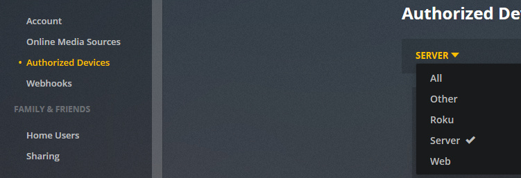

If my memory serves me the MachineIdentifier identifies your individual server(that particular PC) to plex.tv. This is useful if you have multiple PC’s in the house running Plex. You can see how many servers plex has detected from PlexWeb.
Settings → Authorized Devices → server from drop-down.
But nonetheless, there is no real consequence if you keep all the settings from your old PC to the new PC with the exception of maybe LocalAppDataPath or TranscoderTempDirectory but that should not be an issue if you are indeed creating a “prefect clone”
