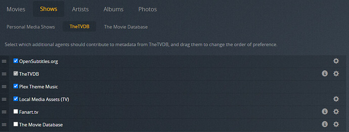

The descriptions of movie is correct language (Hungarian), but the title not, so I think isn’t an agent setting problem.

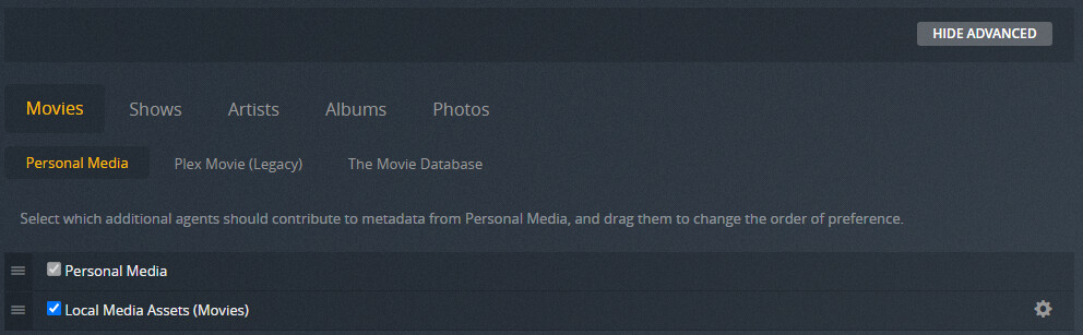

But, I checked the Agents:
And checked the Library settings too:
Before the new agent I used the Fix Match manually (movie by movie) but not with the Plex movie agent, but also I used the IMDB agent (whitch is not in the list now):
