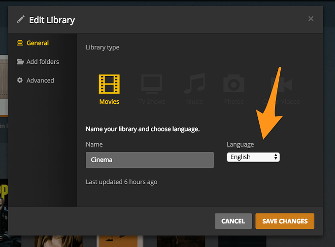

Titles are gotten based on library language ( if available in online source )

@BigWheel, English language is selected, but UK also uses English and it is detecting UK titles.

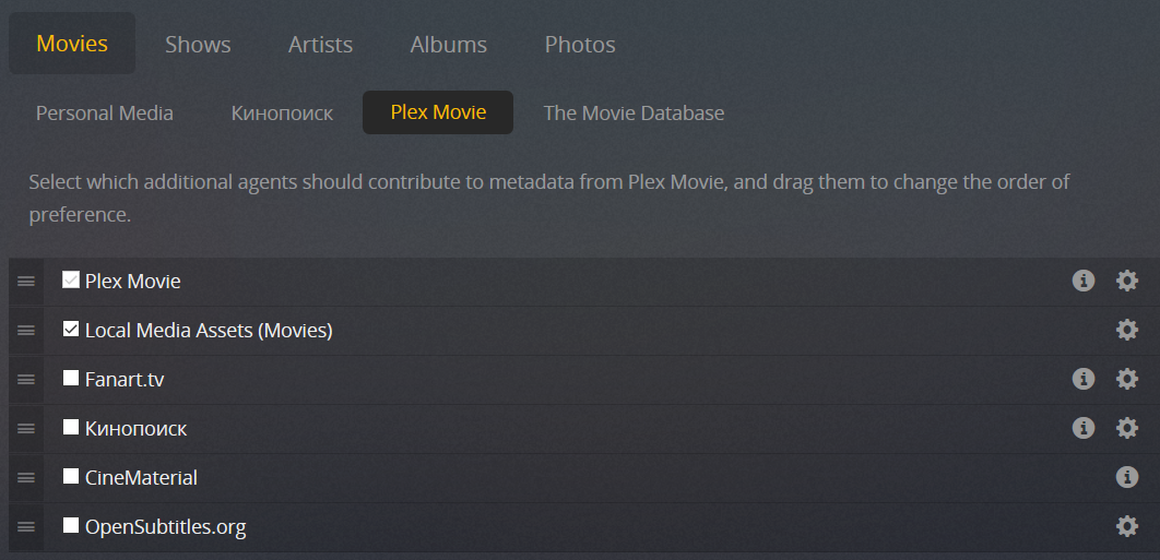

May I see the full ist of agents under
Settings - Server -Agents - Movies - Plex Movie
please?
Here it is:
And that ‘Kinopoisk’ agent has always been deactivated in there?
I am almost out of ideas.
