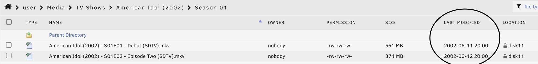

When I realized it was a future date I changed the values using terminal in UnraidOS, but this is the value I changed. (obviously this is good now, but it was a future date before).

Plex doesn’t use the “last modified” date on your file to determine when it added the media; that would be ludicrous and produce all sorts of problems, lol. It uses the current date on the system. So you’re looking in the wrong place. My guess is that your system date was wrong for some reason and that’s why the last modified date on your file is also in the future, just like the database entries are also in the future.
Makes sense. Thanks.
That most likely means that your server machine doesn’t have a battery buffered real time clock in it. Which then requires it to go out on the network/internet to an ntp server to ask for the current time and date.
If that internet connection was not available at the time when the device (and with it Plex server) was booted up, it would used some kind of “random” date.
If you now added media while it was running with a wrong date/time, then that wrong date would appear as the “Added at” date on your media items.
The cure is either to not allow Plex server to be started until after the first successful time sync, or to add a CMOS battery. (if the hardware allows it, that is. Many NAS devices don’t support a battery buffered real time clock. But if it’s a old PC or server, it might be easily fixable by replacing the existing old battery on the mainboard.)
