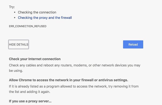

I am having a weird situation going on here. I can access plex when i am local and I go to the ip of the device and http://192.168.1.23:32400/ works, but when i try to access it with my static ip I get
I cannot figure out how to fix it
how come I can access everything fine its just when i change port to 12973 which is what the 32400 is going to works fine. Its just the 32400 port is causing a huge hang up
correct and when i type in static ip address and change port over to the 12973 it works and i can access it. Using the 32400 I cannot
