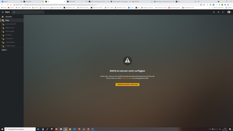

Hi, after a crash I had to restore my DS916 completely from the current backup (DSM7). Until the crash, Plex was already running on DSM7 with version 1.23.4.4775. When reinstalling Plex, the shared folder is present, I can’t get to my server. Message: the server is currently unavailable. Have already uninstalled after reinstalling Plex, keeping all data. Performed reinstallation with Plex claim token. But no improvement achieved. What do I have to do to get my settings and media libraries back?
