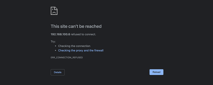

As I mentioned I had everything removed, including my media share. I recreated the media share, gave it the correct permission (at least I believe I did), did the manual install using the token method. Gave the PlexMediaServer the correct permissions. I also setup the log file share. The install completed, but did not run. I had to run it myself. It has stayed up as running but I now am getting this:
I will attempt to re-install with this version that you sent me and get back to you.

@trumpy81
Rebooting my router and everything connected to it would require rebooting several devices in my home network. I can do that tonight after everyone has gone to bed but doing that during the day would cause my family to run me out of the house. :slight_smile:
I will do the install with the token again according to @ChuckPa instructions and see what happens. If I am still getting the site can’t be reached error, then I will do all the rebooting tonight “after hours”. Thanks for chiming in though.

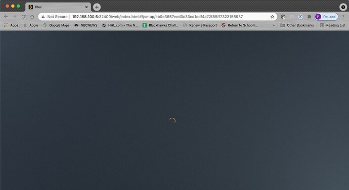

Getting closer. Bounced the DNS server and opened a totally new chrome window.
http://192.68.100.6:32400/web came up and asked me if it could sign into my plex account, I agreed and now I have to he following:
That orange circle is just spinning.
Hang on. I just reloaded the page and to seems to be working. I’ll update as soon as I see if it works.
Wow. Thank you to both @ChuckPa & @trumpy81 for all your help. Things seem to be working and I am in the process of uploading media to the media folder. It turned out to be the combination of using the latest server version, using the token install, and bouncing my DNS server to get everything to work. I have also connected one of my AppleTVs as well.
