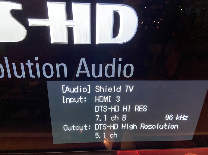

On Shield 2017/ Samsung Soundbar ( supports all audio), I tried the DTS-HD HRA 7.1 sample in Plex and it played as 5.1, so the Soundbar didn’t detect it as DTS-X.
good to know, thanks for testing. yesterday i tried two other movies through kodi both on dts-hd hra 7.1 and both of them where identified by my avr as dtsx but directly from plex app nothing at all no oudio output besides stereo from the shield. And i’m on the 2019 one. it’s not a big deal but i do think plex ad-ons for kodi isn’t as good as the plex app in terms of graphic and comodity usage.
