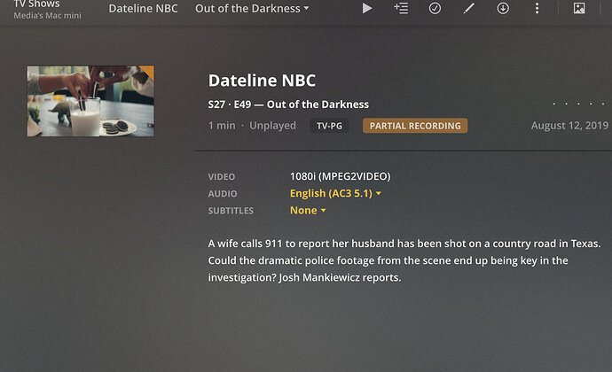

Here is one that happened 2 days ago.

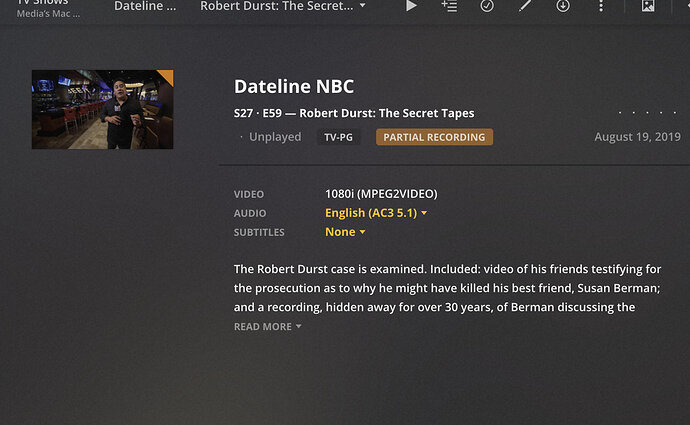

Heres the 3 most recent failed recordings.
Can you please help me by telling me the time of each of these curtailed recordings and the channel. These are August 2019 and a 2018 episode so cannot tell from the screenshots that they were recorded in September 2019
The only DVR activity I can see in the logs which cover September 14 to September 30 are these
