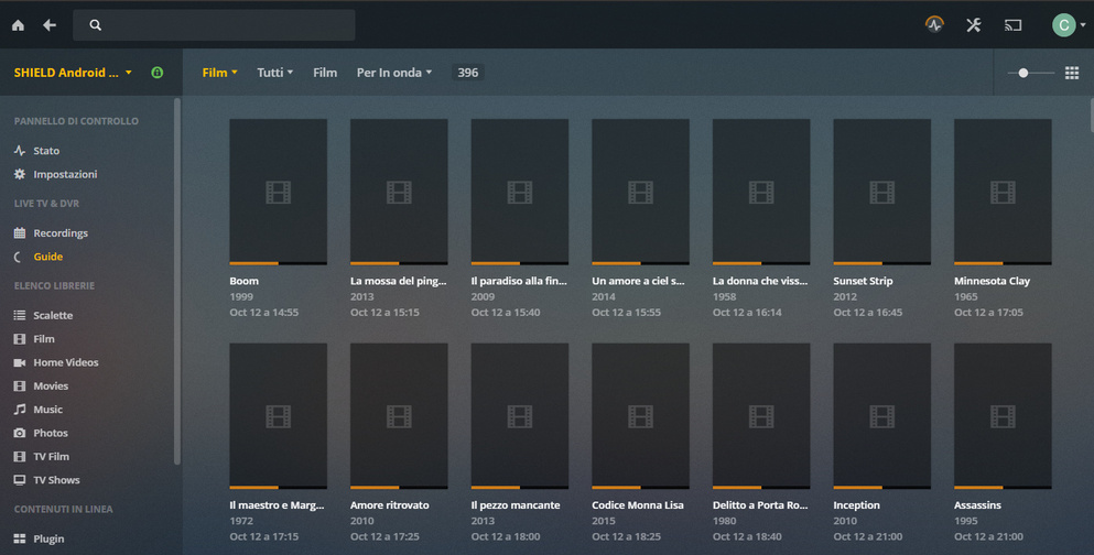

The TV guide is empty apparently because downloading the guide is stuck “Initializing”.
None of the TV shows are being recorded apparently because the “TV Guide” is empty.
See attached image.

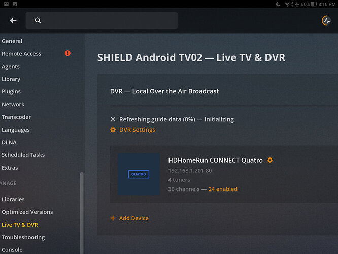

Same problem.. I also have HDHomeRun Connect.
Instead the standalone App of HdHomeRun works fine.

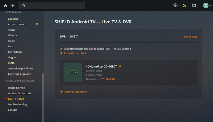

PMS starts trying to update the guide and the result is always the same: “Refreshing guide data - inizializing”..
As in the attached image I have this problem from october 12.
